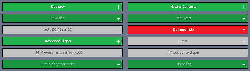

can somebody please tell me where the switch for this red "dynamic ratio" is located, just loaded preset in 9.10 and I get this, never turned anything on but I can't get it off either
https://maasstad.online/
PostPosted: Wed Dec 05, 2018 5:05 pm
Posts: 11520
In all the compressors, there'a Ratio setting, but also a Max ratio and Max ratio at. If those are used (Max ratio at higher than Ratio), that's this feature. I don't know which of the compressors it can be, it's probably either those in MB1, MB2 or the singleband compressor at the end.
