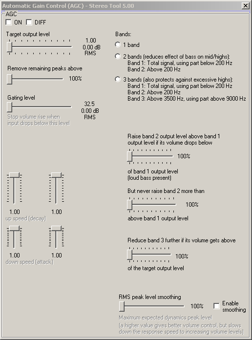

Hans is it possible to change the layout a bit and add a more than welcome feature?
I would change the AGC window such as we write in the Western world, meaning from left to right. By this I mean the input going in on the left and adjust your way out to the right which passes it on to the next part of the processor, the multiband in this case.
A very nice feature would be a level out, or drive, which would 'drive' the multiband.
Luke,
To control the output level, use the top left slider: That controls the AGC output level. (Hm, I see now that there's no text there that says what it does :shock: oops!)
The current layout is based on:
- Basic options on the left
- Advanced options on the right
Which is what I used for most of the windows.
Having said that, the current layout doesn't really make a lot of sense - for example the settings for band 2 and 3 are placed ABOVE the selection of the number of bands... So a redesign of this window is definitely necessary.
Also, I still need to add a new option: Dynamically reducing the 'remove remaining peaks above' level if the volume has been low for a while. So a new track doesn't start at a too high volume. OR maybe I should lower the output level a bit in that case. Still thinking........
 Post subject: Re: Stereo Tool 5.00
PostPosted: Tue May 18, 2010 7:27 pm
Posts: 11456
I have uploaded a new version where:
- Original Multiband is restored
- AGC remove remaining peaks further improved (some bass sounds caused some distortion, now that's gone).
- AGC works also on lower latencies. (Although I might have to change the 512 sample latency version a bit)
Luke: For the AGC window: Is this better?
mmm should be better but I am not sure that what you describe is the output is actually the output.
To me this is the treshold.
Maybe also an input meter on the left and an output meter on the right.

Sometimes meters are missing (last few betas)
i see that on your picture too.
Or that's development..
This picture is development, but the meters should be there in the BETA's... Are they completely missing, or not enabled, or ...???
