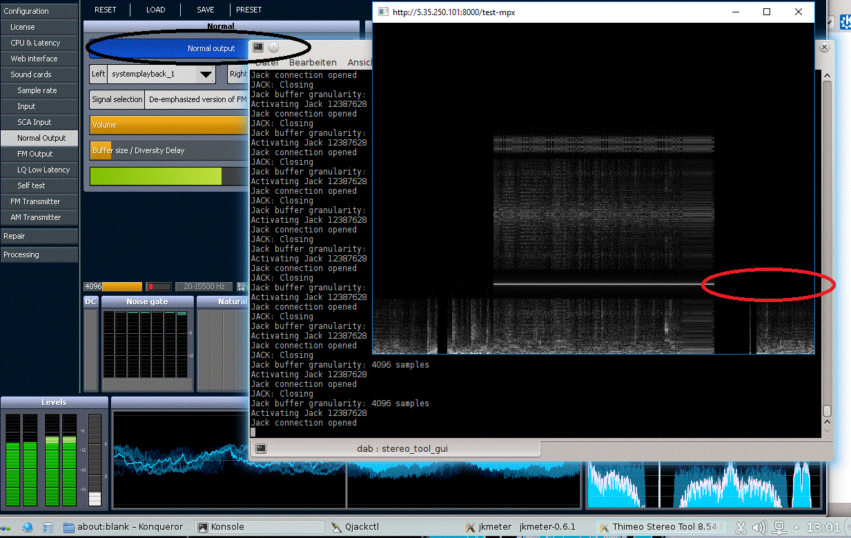

I'm running the 32bit version of the 8.54 Jack Linux Version (is there any newer beta?). Jack is set to 192000 Hz. The FM Output goes into Liquidsoap and produces an 192000 Hz FLAC Stream for MPX Streaming. When I additionally switch on the Normal Output and set this either to a soundcard or any other Jack software the FM Output looses the complete FM part. Please see screenshots:
Without Normaloutput:
With Normal Output:
I'd like to stream MPX as well as normal Webradio from the same unit.
PostPosted: Wed May 09, 2018 2:18 pm
And FM output is not set to the same Jack output??
PostPosted: Wed May 09, 2018 4:00 pm
Posts: 49
Yes:
PostPosted: Wed May 09, 2018 4:08 pm
That is very odd. Can you see anything in qjackctl? The audio that's sent to the sound cards is the same as in Windows (only the output itself is different, the whole sample rate handling etc. is the same).
Which would mean that if you try this on a PC, it should fail as well, unless Jack does something odd.
PostPosted: Wed May 09, 2018 4:53 pm
Posts: 49
With the 9.00 Beta 065 i can't reproduce it in windows. Do you have a JACK Version of that Beta, too?
PostPosted: Wed May 09, 2018 5:22 pm
Not yet :( but nothing changed in the sound card code between those versions. I'm still kinda suspecting Jack here....
