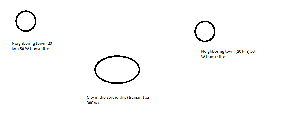

Hello, first sorry for my English. I write because i need good help.
My idea is to install three stations in several cities (at a distance of approximately 20 km of each other), using a single frequency.
I have many Doubts about how to configure this. Such as I link the three transmitters? I can do it for streaming, or analog trunks or if I need to send the signal mpx? That is an additional problem using DTMF tones (using RadioBOSS) I will replace commercials in each city. That I would not mind at the time of advertising can produce some interference to any listener who is in the middle of two stations. Thank you

Those transmitters are on same frequency ?
