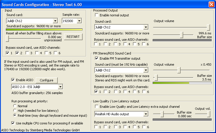

Tested with version 31G. This is what i get when hitting RESET and then loading the preset i use for FM and then hitting RESTART a couple of times.
Could you try what happens if you set the FM buffer a bit higher? I'd like to know if the buffer is then _nearly empty_ or _nearly full_. (Based on what I see, your buffer size is 2 ASIO 'grains' - and after hitting RESET you get only 1. But is that actually '3' (ie. buffer is too far ahead) or '1' (buffer is lagging behind)? That should be visible when you make the buffer a few grains bigger... Thanks!

How much is one grain? The previous example is with granularity of 256 samples.
When i set the buffer to 2.8 ms the left half of the green balk stays filled.

Tested with version 31H after changing the buffer a couple of times i get this with 8,5 ms. So no flickering in the white part. And after a few seconds lots of clicks.

And this is with buffer of 3.5 ms.
Ok, clear. Only I don't understand why you still get clicks. I suppose this is even without moving windows etc? The buffer seems to be full enough - even though it's not completely full.
Last question (and then I'm going to take some time to think): What happens when you have this situation (including clicks) and select Bypass mode?

In this situation i also get clicks when i don't move windows indeed. When i select bypass the clicks are gone. When deselected clicks are back.
Ok, one more then (sorry)... What happens if - instead of selecting BYPASS - you just turn a lot of processing steps off?
