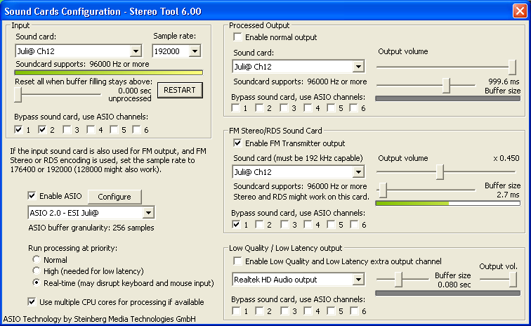

http://www.stereotool.com/download/radi ... 1-031G.exe
Could you check if the issue with buffer that are not completely full after hitting RESET is gone?
I've made some changes - turned out that I started the ASIO thread BEFORE I configured which channels are enabled and which are disabled. Now I would expect the thread not to kick in that soon - but if it does it could do something like that.
Edit: Odd, first startup behavior is wrong again. After hitting RESET it seems ok...
Edit #2: Cause found, after first RESET everything should be ok - before it's not.

Tested with version 31G. This is what i get when hitting RESET and then loading the preset i use for FM and then hitting RESTART a couple of times.
