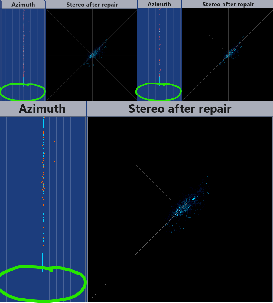

EDIT: So, I recently learned that the scopes, goniometer, and AZIMUTH rely on legacy code where it's unscalable, and one pixel is 1 pixel. This is becoming an issue at 4k. The AZIMUTH correction line is extremely thin at 4k and doesn't scale with the DPI. Notice how the bottom of the AZIMUTH correction line doesn't draw all the way (circled in green). And the goniometer could use a faint antialiased line connecting the dots. Do I need to send my skin?
File comment: resized 50% filtered, resized 50% linear, and sized 100%.
Also would it be possible to antialias the scopes, or is that overkill? It just looks a little incongruous with how smooth the rest of the new UI is.
That's odd. I have a 4K screen and AZIMUTH does draw to the bottom. What's your scaling in Windows set to? 150% (default) or something else?
Connecting the dots in the goniometer can quickly get really heavy in CPU power, because we would need to draw lines instead of separate dots. For the normal scope we can combine things vertically (there's a limiter number of pixels), for the goniometer that will likely take a massive amount of CPU, which would also depend completely on how loud the input is and how many high frequencies are in it.
I see. Gotcha. So combining things vertically would be like a large vertical resolution downscaled to look smoother? Or am I completely missing the point?
(edit: oh I see, you mean drawing lines vertically between the points on a waveform? So does that mean antialiasing is out of the picture for now?)
4k @ 200% DPI (detected 192), scaling of 125% in ST with mostly small fonts and 50% compactness. I'll include the skin section in an sts. Winamp Modern colors by Valiant.
