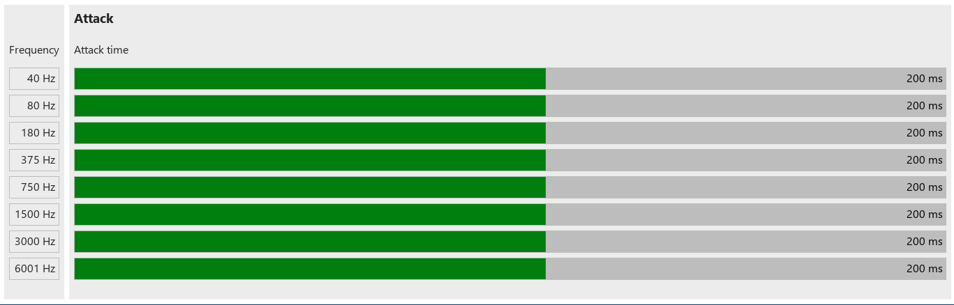

PostPosted: Fri Aug 18, 2023 11:31 pm
Posts: 88

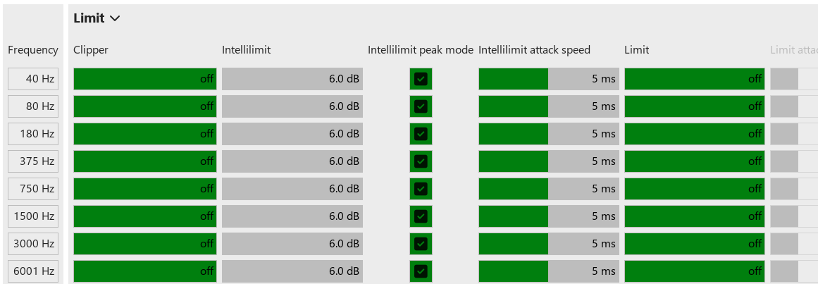

Changing the Intellilimit slider doesn't appear to do anything. I've tried different levels, enable/disable peak mode. It doesn't appear to do anything?
Is your limit speed a lot faster than your main speed? If it's too slow it might have no effect.
My primary attack for the Adaptive compressor is 200ms.
I've tried various settings for the Intellilimiter but don't see any change.
I am testing with the WinAmp plugin.
