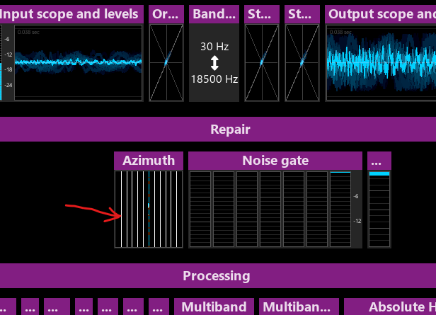

Just noticed on the: Beta 10.02-089 release that the lines
on the Azimuth graph are a really prominent white now.
Would it be possible to have them toned down
a bit to a mid grey as per the other graphs on the
next release?
Regards
Mark
Done!
