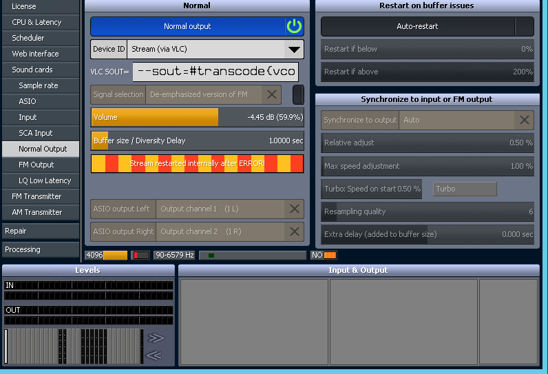

I have a ST 8.00 running in this configuration:
- Input via VLC
- Output via VLC to Icecast
When I start the program first time and I enter all streaming info everything is working fine
When i restart the program, the sound is distorted and too slow on Icecast and the Soundcard Output looks like in the attached screenshot.
I have to delete the ST INI File and reconfigure it, but it works only until ST is restarted.
This is what VLC logges:
[00000072e0f98ef0] logger interface: VLC media player - 2.2.4 Weatherwax
