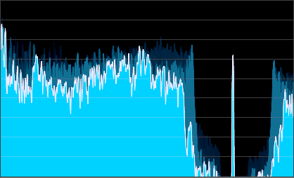

There is a sample rate bug. The sample rate of the FFT is stuck in 48khz mode. Restarting st fixes the problem but it switches back to 48khz by itself after a while.

Saw that in beta5 but not in beta6. Now i see bug in MPX power meter.
