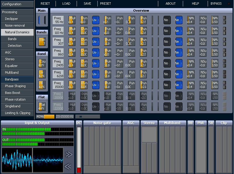

In the VST it is impossible to chance parameters, because you didn't see anything. but i cannot chance the window size as well. can you change this?
PostPosted: Tue Jul 30, 2013 7:06 pm
I saw the same on my pc, you need big resolution to view all buttons and sliders.
And that is with stand alone version.
