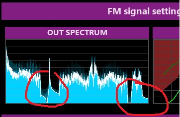

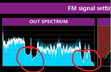

Under FM signal settings, OUT spectrum is not showing right. It has some strange jumps, most visible around the pilot and RDS, may be incorrect drawing or wrong detecting for drawing the display.
The real output signal is OK on my side, but you may check it too.
I`m talking about Stand alone 32 bit. May be check others for the same.
