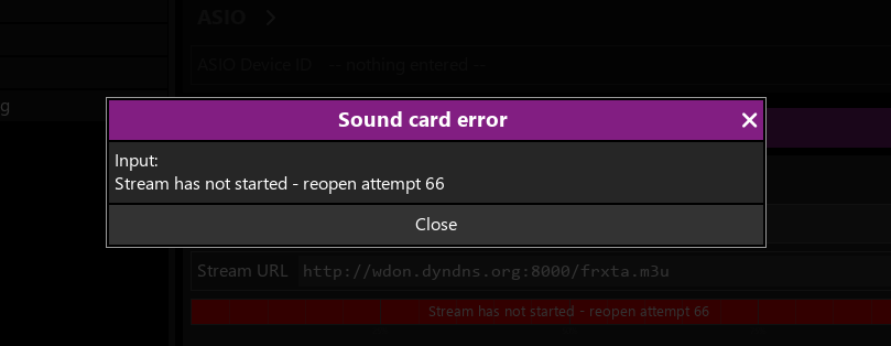

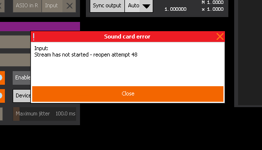

Tried an easy stream in/out thingi in regualar Beta 10.02-009 and in latest "New Interface preview Beta v10.02-007"... VLC all new installed. And an "All New Win 10" too.
The URL I give ST is real but it wont take it. And it will not stop nagging about it either. I have to kill ST and delete the .ini to start over, and no-way can I make it read a stream that older versjons read perfectly. Am I all into some new stuff I dont know about or is there a new bug I havent cought yet :) (I never got the covid one either).
It never gives me the option to correct URL, it just spawns numbers it tried to connect but it failes.
BTW, I do love the new setups, it even sounds better. At the moment I'm trying to update clients presets....but hehe no stream in no fun out :)

I just happened to run into a similar issue today, but only with too new libVLC versions (and on both the old and new Stereo Tool frameworks). Are you really sure that it works with the old version on the same system?

I've got a 9.92 on the same pc reading stream in and giving it out with out problems, and I also using a Sonobus on the as a backup. It works.
Its kinda weird, but its good to know that its not just me then :)
