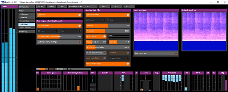

This looks off to me. I don't recall seeing the blue sections under the graphic spectrum displays on Delossifier:
DSP beta 22. Windows 10
