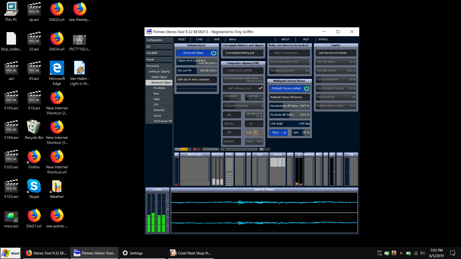

PostPosted: Thu Jun 06, 2019 2:10 am
Posts: 49
Limit Output instead of clipping under the advanced clipper is busted..
PostPosted: Fri Jun 07, 2019 9:16 am
Posts: 11519
BETA014 is available and fixes this crash.
