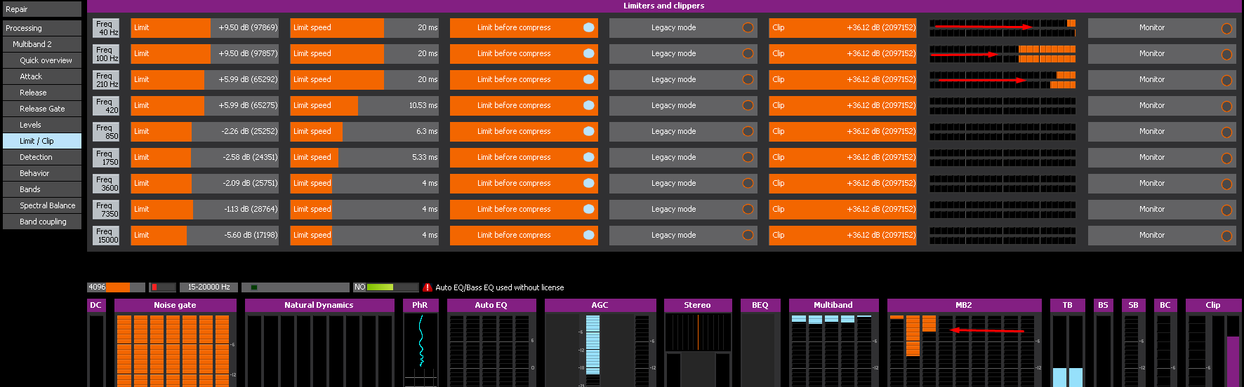

When you apply clipper in MB2 and disable them meters are freezing.
Look @ pic. You have to restart ST to reset them.
