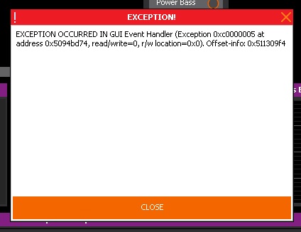

I get an exception in beta 060 when i load the new presets from Wes and Bojcha
PostPosted: Fri Apr 06, 2018 3:48 pm
I've got it here, too. Looks like the preset still loads, though.
EDIT: Oops, no it doesn't. No clipper loads. So it's nonstop distortion.
EDIT 2: Because I'm not sure the presets are loading correctly (I know at least the clipper isn't), I'll attach the original of Mousse here. That is a FULL preset, use proper technique when loading it. If the other variations are desired, I can provide them.

Hi Wes, I have download your preset Mousse-0.13 And load it in ST and it works fine. I have tested with all options All (Audio)(Audio and FM) and All settings. I get no exception.
PostPosted: Fri Apr 06, 2018 5:46 pm
If you load it yourself, you should be fine. The exception only seems to happen when it gets selected from the built-in list. So I provided it here, in case anyone wanted or needed it.
