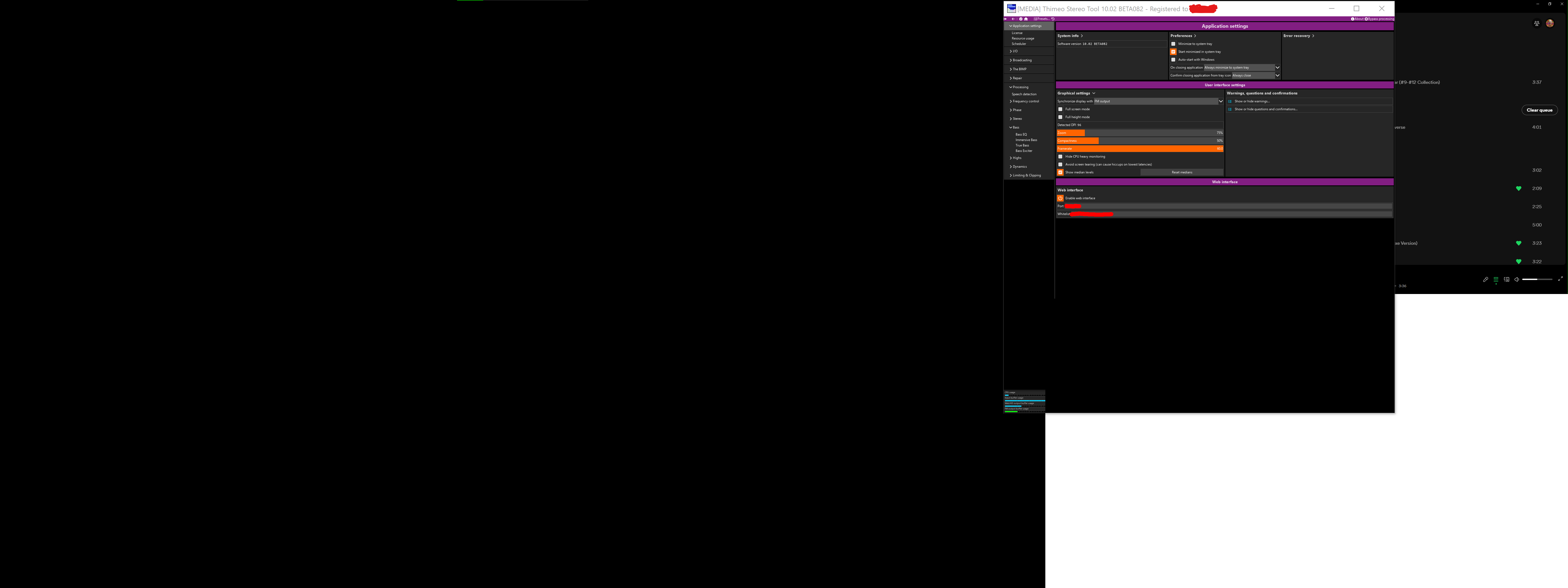

So, the first issue I'm experiencing is when it's on my secondary monitor (1080p @96DPI) the vertical size wants to stretch past the window and won't resize (even when I try to force it with a key combo from DisplayFusion); horizontal works. Full Height Mode is off, though I would guess this function might have something to do with it.
I can't tell, but it might be trying to size itself up to the vertical resolution of my primary monitor (4K @192DPI) while on the secondary. I don't have a tertiary handy to test with. edit: NOPE see the images
One is dragged off-screen slightly into the primary monitor. You can see where it extends to.
The other is immediately clicking Full Height Mode afterward. Hope this helps.
Also, can we get the forum software updated to take WebP images as attachments? They're much more efficient than PNG, and screenshots don't require editing to get under the file size requirement. My background is indeed black, but I have to black out the desktop icons cause they're too detailed and inflate the size.
edit2: fixed images for privacy
edit3: This is the preview image from the taskbar. Notice the Absolute Highs meters are showing below the part that's offscreen?

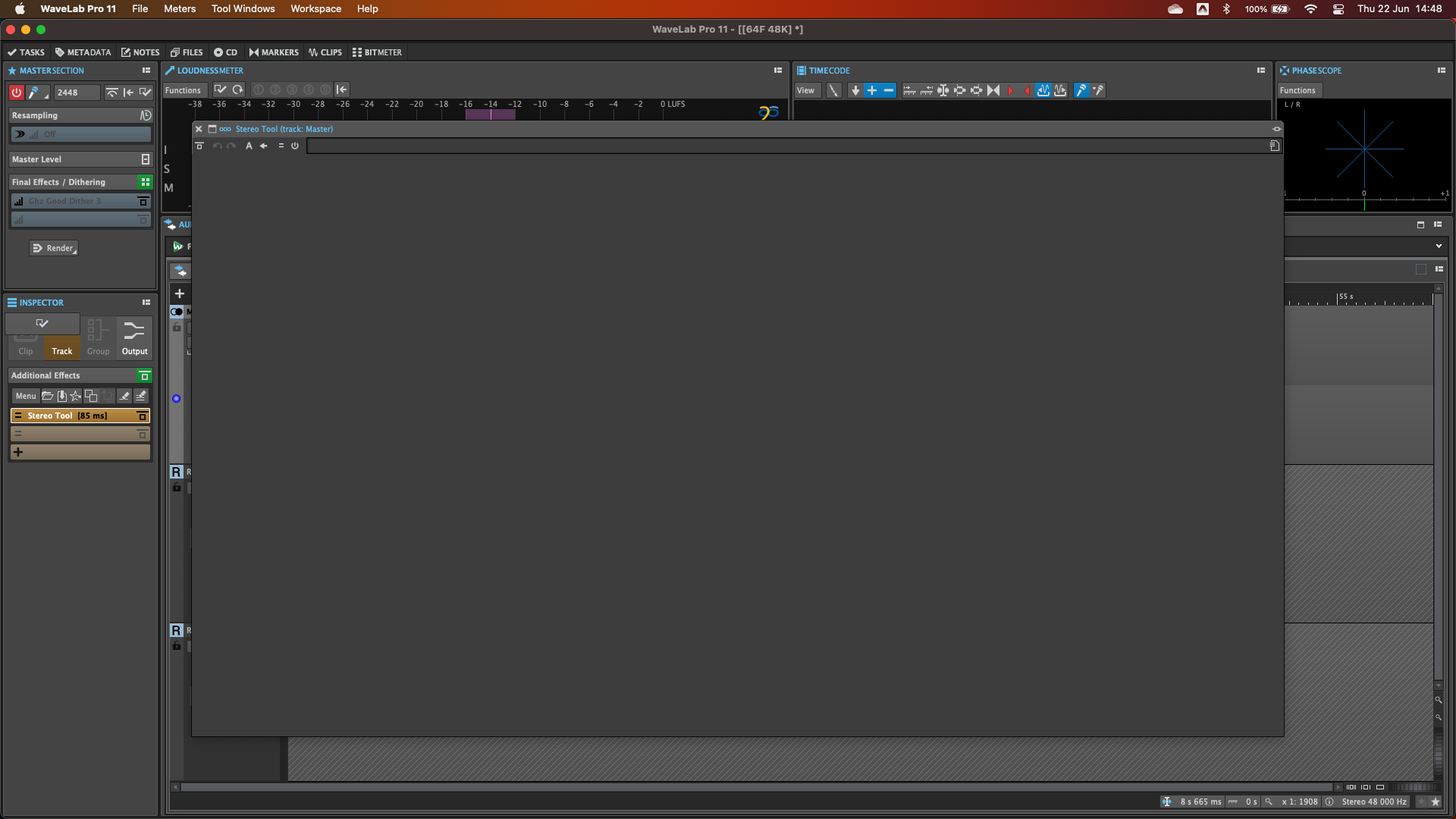

Just tried this is wavelab 11.2 macOS 13.4 Macbook Pro M2pro, The screen now opens the correct size with the vSt3 version, but screen still blank.
Thanks
