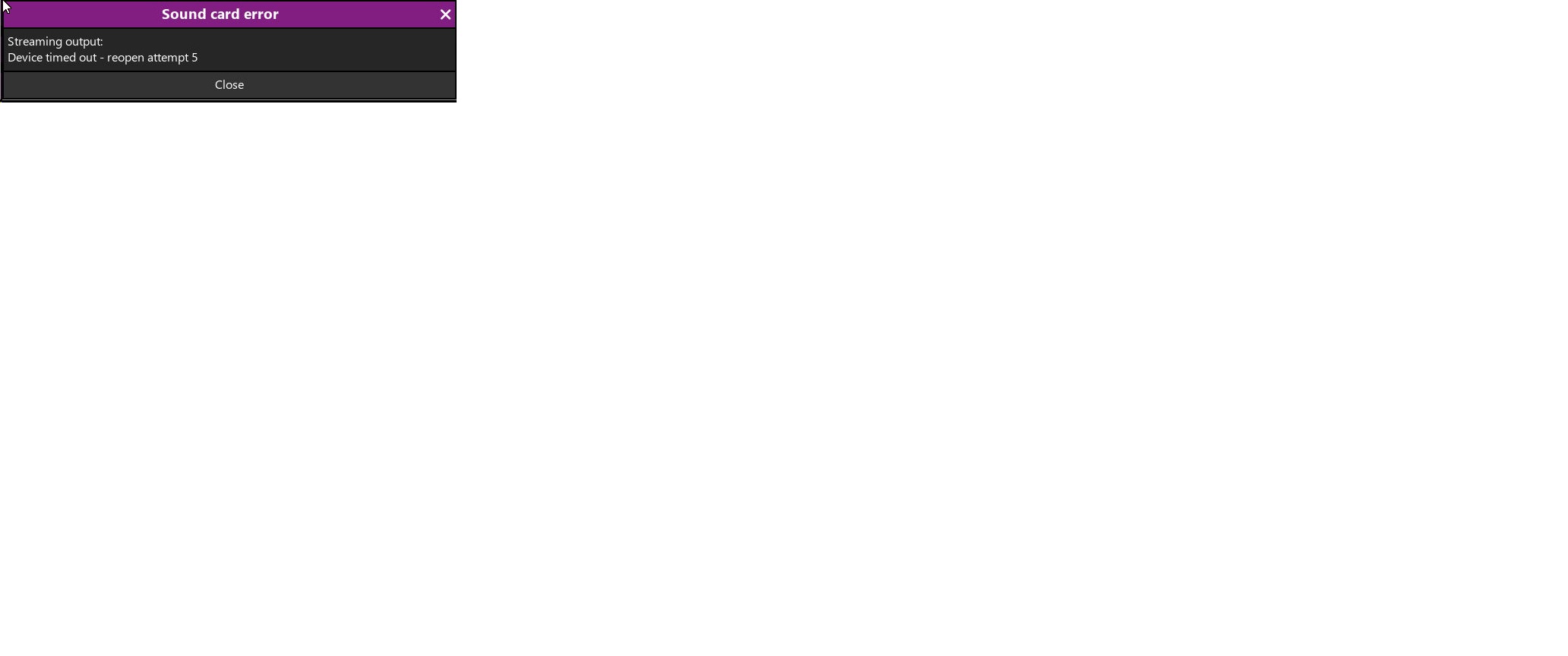

I have this error.
i have no soundcard only VAC
