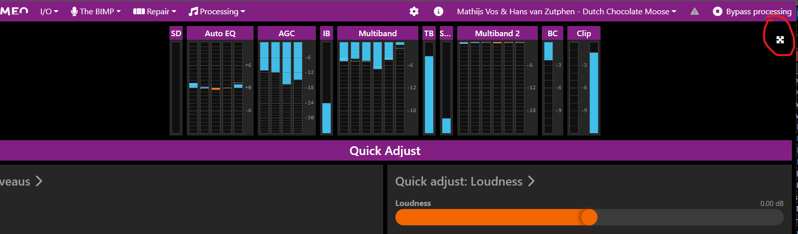

They are not visible at first, when i click the icon in the red circle the error appears
Ah! Yes, confirmed, now I'm seeing it too. But it only happens with the old GUI version and the new web interface; that was kinda important information :)
just uninstalled the beta version and downloaded beta 21, suddenly i see the new interface in the standalone version, didnt see it before ( think i installed the beta's from 004 )
now with the new GUI the problem is gone in the Web interface.
So problem solved for me, thanks Hans.
I also found the issue, it was one of the memory reduction things that we did recently. So it will be solved in the next build.
