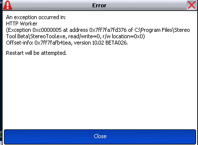

I get an error in beta 25 and 26 StandAlone 64 Bits Windows version, when activating the input/output scopes on the meters view. all meters freeze and in ST an error appears (attached image)
PostPosted: Fri Dec 23, 2022 1:50 am
I don't see it here, what are you doing exactly? "activating", they are always active?
