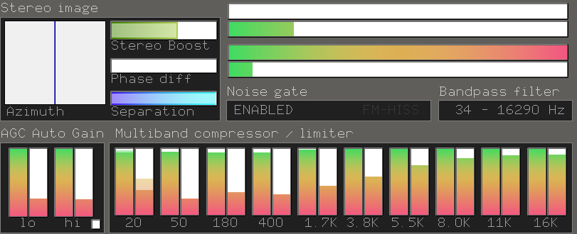

I notice a bug. When i open a preset sometimes left and right get swapped. Best way to check this is changing buffer size with mouse wheel. Then even when the number doesn't change left and right swap. See input and output meters on the attachment.
I tested it with the stand alone version and with ASIO on and off and both times i have this problem.
EDIT: I also tested it with winamp version there it's ok.

@eldoradofm: Hm, will check... Given the description I think this problem must also be present in all previous versions...
