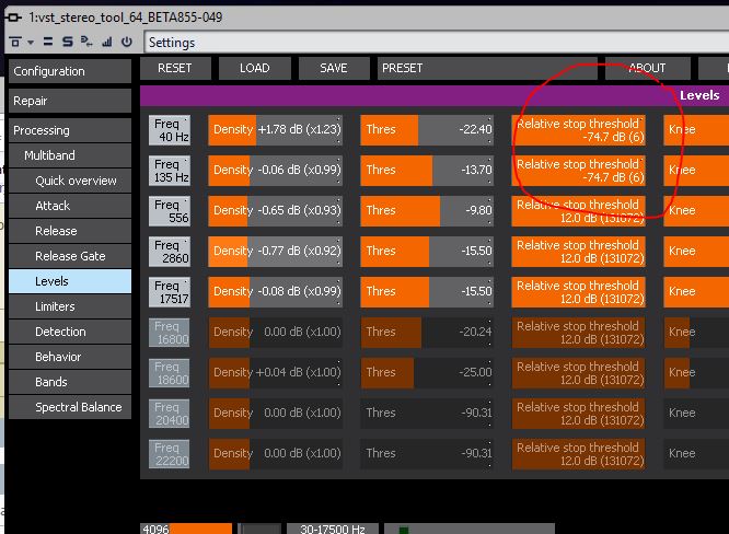

In multiband-levels there is a setting called "Relative stop threshold". Default is 12.0dB (131072) but after I select it, it jumps directly to -74.7dB (6) and from then on it it is only possible to adjust it between -99dB and -74.7dB
I use the vst 64 bit version 8.55.049 Beta with Wavelab 9
I double check it with your latest version .052 and it's the same.
Bug in slider. I'm also waiting to be fixed. Can be tuned from sts tho.
It's interesting settings since it's not so fixed, it's relative. Might be good to be even more relative.
