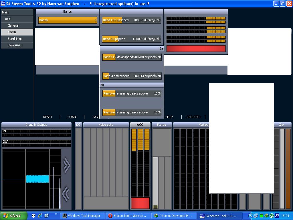

And for AGC i mean this on the picture.
fitted in place .
White places are where i cut the picture to build what i mean.Don`t look there :)

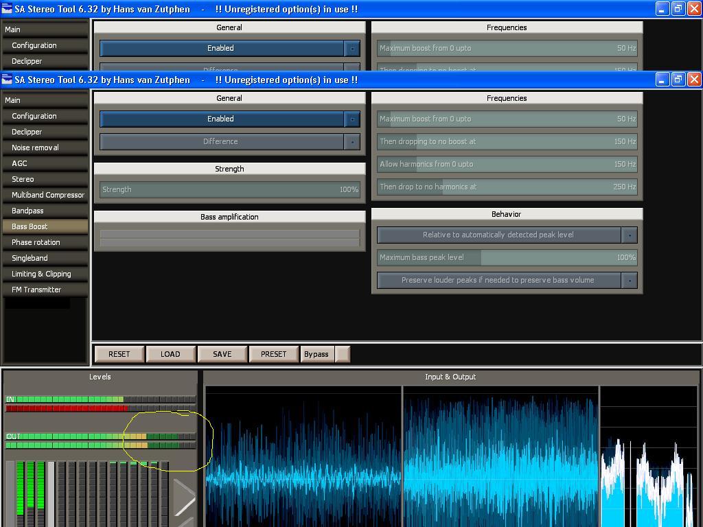

I want to know what is "preemphasis indicator" ?
PostPosted: Fri Oct 26, 2012 3:42 pm
See the double indicator ? Bojcha
The green one under the main indicator is when "preemphasis" is ON.
