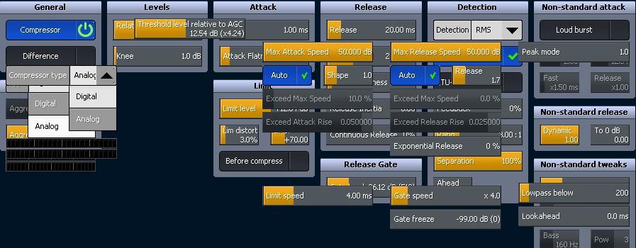

In AGC->Compressor ("Show deprecated settings" is OFF) , when you enable Compressor, on the Quick adjust there is some mess with options - one above another and some drop down menu is showing with Digital or Analog selection ?!

Can you post a screenshot? It looks fine here, although I could imagine that after switching between Analog and Digital if the screen cleanup wouldn't work it could look messy.

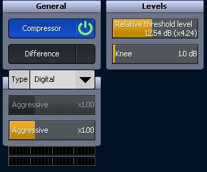

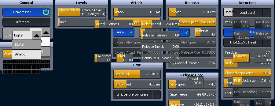

When i switch any other window and come back - it looks OK
But if switch it ON only - i get the only this showed on litle picture
Then if i switch between digital and analog - other two pictures
Then if i go to some thing outer the ST (for example start menu) , it cleans and looks ok.
Looks some refresh cleaning window problem ?
Edit: during the "mess" i cannot highlight the menus , when hover over the panels below the settings.

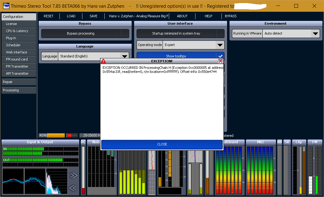

I get a screen like DJ-DOGGY when I am selecting Analog/Digital also however, it goes away right after selection is made (mine refreshes) :roll:
In this version 066 when I select DELOSSIFIER>Spectral hole filter I get a window error "Exception occurred in Processsing Chain H ..." and then the audio slowly goes away until I turn it off, then the error window can be closed. ;) I checked older versions and they didn't have this problem.

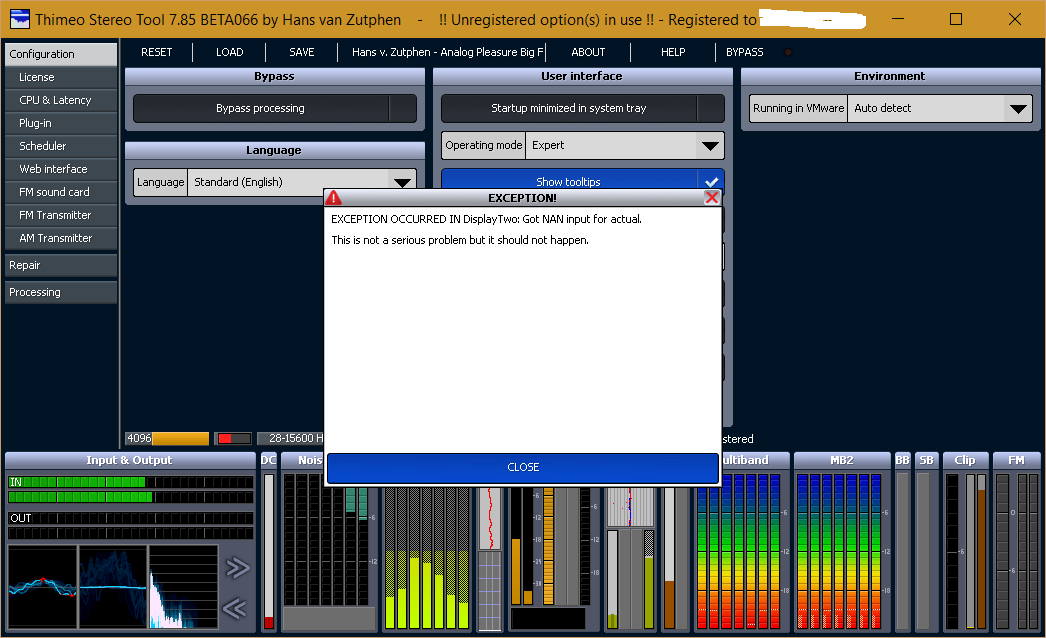

Serious issues in 7.85 BETA066. 2 errors pops up all the time and music sounds terrible.
