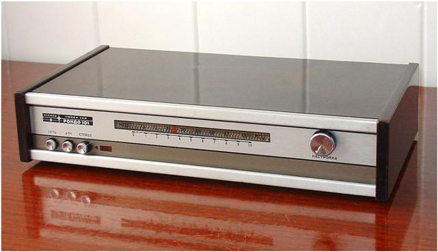

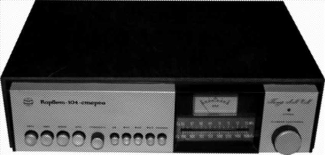

You must use a russian ukv tuner with Polar Stereo like rondo101 or Corvette-104 Stereo. Some Stations in Russia use Polar-Stereo, other Stations Pilot-Stereo. If good sporadic E conditions,
You can receive many OIRT stations from Russia, and countries of ex USSR like BY, UA and MD.

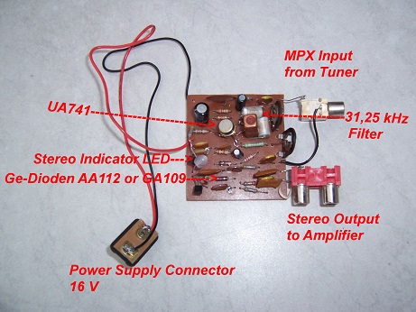

My Home made Polar Stereo Decoder:

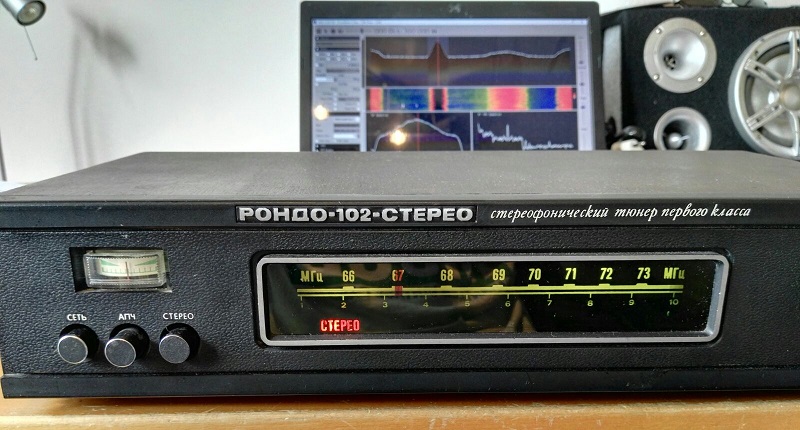

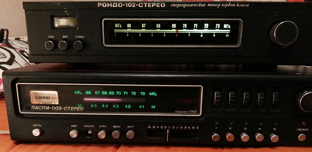

I have bought some equipment in eastern Europe earlier this summer. The seller asked for what purpose we wanted to buy such old equipment, he didn't knew about polar stereo.
While staying in Moscow I received some local stations. I am sure they are encoded in Polar stereo. I have listened to these stations with this receiver and they had a nice audio separation.
Today I did a small test and made a small recording, the audio is coming from the Rondo 102 tuner and the video is from SDRsharp. I have to say that I am not really impressed at this moment the audio separation is not as it should be. Just have a look to the video and give your opinion, I will keep testing.
https://youtu.be/E_wq-wfU6n0

Thanks for this nice Video !
Those Tuners support 100% Polar stereo I see it in the Schematic Diagram.
The Audio Channel separation is not so good, the same as my home made polar decoder.

@marcy311 Interesting materials, was your test with polar stereo successful?
I have done a few more tests, I found out that some solderings of this old tuner were dried out.
I suppose this old tuner just need some love to functional properly, I renewed those solderings and everything seems to work fine.
I did another test and it seems to me that the polar stereo works perfectly in Steretool.
In this video below you can see the result:
https://youtu.be/bpcDCA_DdmI (at 2:04 I play a stereo test sound, check the channel separation)
