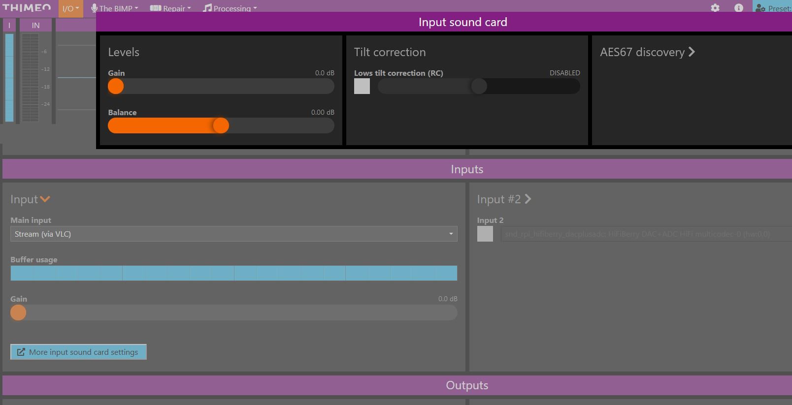

Please can someone tell me how do I enter the address when I sellect main input "Stream (via VLC)" ?
I cant find it anywhere :cry:
PS I'm trying to use software version 10.00 on a RPI 4B 2GoRAM + a basic Hifiberry DAC+
Thanks ;)
PostPosted: Tue Jan 03, 2023 2:06 pm
Oh! That option shouldn't be there in the Linux version. So, the answer is that you can't :(
