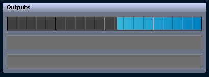

oh, i kinda likes the old meter behavior, the new one is sort of backwards when it operates (9.92 beta 5).
PostPosted: Wed Jun 15, 2022 5:46 pm
it IS backwards.
Anyway, when we are on that bar..
- Why all sliders still does not have right and center click function? Same is for many places in old and new gui too.
- Why that bar is so jumpy with lower buffer values, however in new GUI and only in Input Sync section is nice and steady.
- Any chance for that 'buffer filling' numerical percentage in old gui?
PostPosted: Wed Jun 15, 2022 6:16 pm
it IS backwards.
for me, im not so into the fancy GUI looks, i prefer advanced displays and advanced settings over "candy" looking GUI's and simpleton settings.
i havent tried ST 10 because it seems the GUI and settings are geared for "dummies" and i dont like that, unless there is a checkbox to revert the GUI to "advanced" for people like me. (i have not read the thread discussion completely)
not that i mind this backward meter operation, it still functions like before, i just have to get used to seeing this way however, i suspect new users will be quite confused with it because i sure was when i first saw it.
