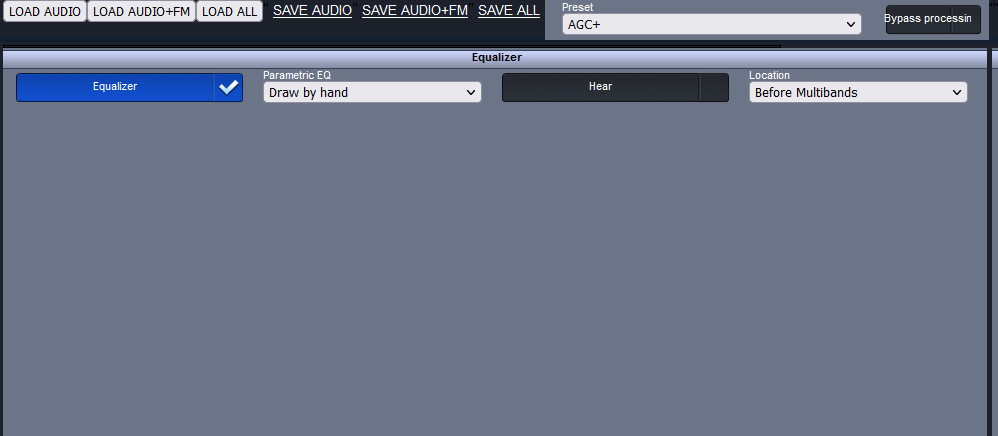

I have problem with web interface. Buttons are not working at all and no meters like eq graph and vu. Browser FF last or edge(chrome).
At the /modern/ page falling into infinity loading.
But nobody posted about it so what do i wrong ?

Weird. I see here that *drawing* the EQ in the old web interface fails. But aside from that everything works, in both the old one and in /modern/ (in your screenshot it's not even visible).
Which exact version of Stereo Tool are you using?
Can you press F12 in the browser, then go to Console, and show what it says there (mainly if there are any errors, they would be displayed in red).
