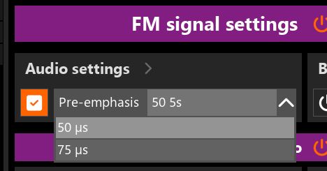

In last 3 releases Windows Standalone x64, DSP, VST... show 50 5s instead of 50µs in FM Settings
