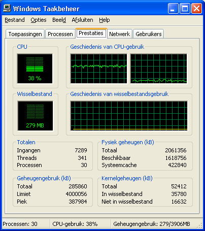

I'll do some more testing. This is my CPU load with version 25, version 26 is about the same i'm using E6500 dual core CPU.
edit: I'll do some testing with 40 Hz tone like bojcha did.

eldoradofm: I got some advice from someone that might help. I'll build another version tonight where the maximum 'schedule out' time for the processing thread is reduced from 16 ms (the default setting in Windows) to 1 ms. That MIGHT help a lot.
I'll also try to spread the processing better over the 2 cores (with the changes in BETA26 I think that's now possible without risking a latency increment, which would be there in earlier versions).
