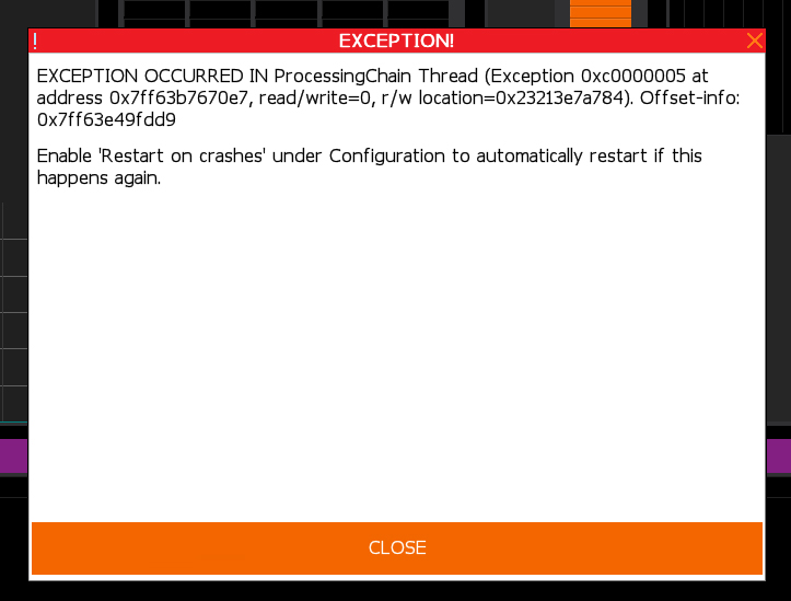

PostPosted: Sat Mar 17, 2018 10:31 am
Posts: 152
Location: Sydney, Australia
8.55 BETA046
Stand Alone x64 version
Windows 10
4K Monitor
Can't close it, I have to close ST to get rid of it.
C.
