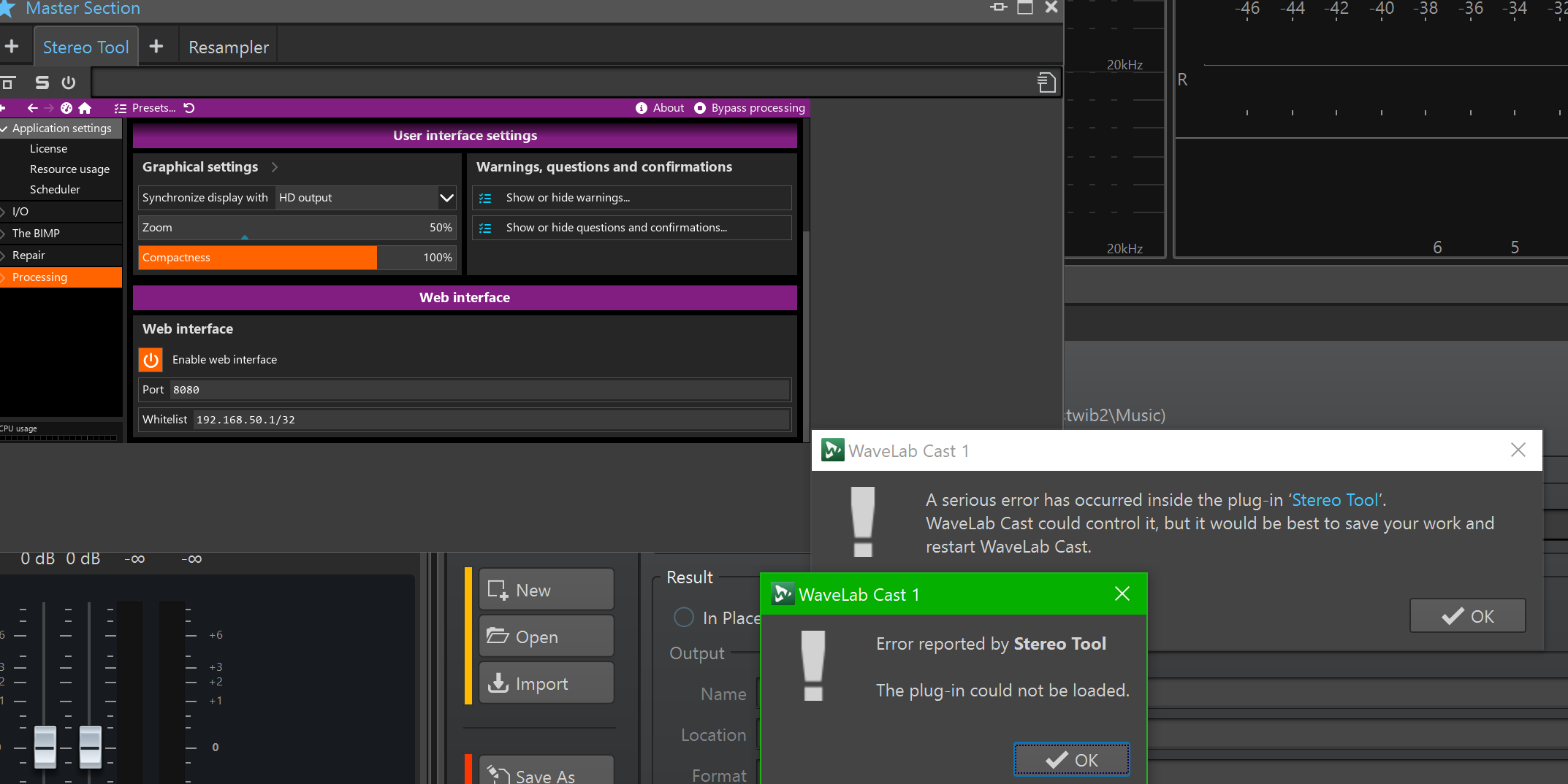

Steinberg Wavelab's host doesn't seem to think the VST3 64bit version of ST is a proper plugin upon pressing the render button. It plays back perfectly, but the render option makes Wavelab give an error that Stereo Tool doesn't catch.
More in this thread: viewtopic.php?f=4&t=33556
Also I'm getting the DPI scaling curse on different monitors again. It keeps wanting to shrink the window when swapping between.
Since this is an official Steinberg VST Host, maybe it would be prudent to make it as functionally compatible to its requirements as possible? Surely this would make it more compatible across the board as a side effect. /shrug
There a big VST size fix from Tom coming, which appears to work fine now on all the hosts that both I and Tom have on our pc's. VST development is hell... For the VST3 issue: Do you have a screenshot or the exact error message? And I assume that the host is 64 bit? Because otherwise if multiple copies are loaded it might at some point be out of memory (a 32 bit application can never use more than 2 GB in total, so that's with all the different plugins loaded). It seems VERY weird that it can load the VST for editing/live processing but not for rendering, inside Stereo Tool we cannot even see the difference between those two - that's why I was thinking about memory issues.
The info is not very informative so I didn't include a screenshot before.
I'm excited for the sizing fix. The host and VST3 are indeed 64bit. Very weird indeed. I'm running the trial right now for Wavelab Cast on win10.
