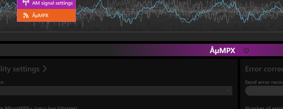

I've updated to beta55 and the webserver seems to be working how I would expect as long as I run the application as my user. Is that the suggested best practices? Or should I run it as root (web server doesn't work)?
I have a minor bug report of how "µMPX" is rendered as µMPX (A with circumflex). I see this in the native application (Running on Ubuntu 22.04, and setup for English (US)) as well as the web interface on Windows10/Chrome, computer is setup for English(US). Screenshot of web interface attached.
