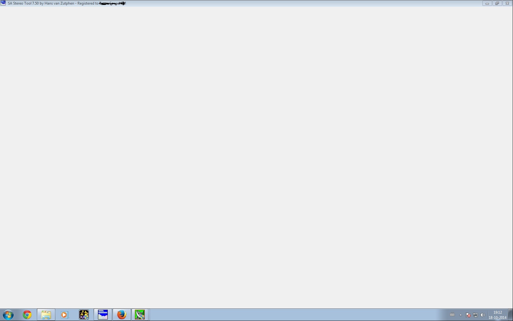

NO GUI after a longer test; GUI dissapears but stereotool continues to play processed audio.
For now I'm waiting if stereotool will crash or not.

PostPosted: Sat Oct 18, 2014 7:26 pm
Posts: 4229
did you try to exit from "Full screen" ?
PostPosted: Sat Oct 18, 2014 7:30 pm
Posts: 140
Yes, it stays the same. Stereotool is responding, because the SA GUI mouse arrow is showing and if I want to exit SA it's waiting for my '' I'm sure''.
starting a second stereotool gives normal screen (GUI) for that one.
EDIT
Closing by taskmanager (couldn't close it the normal way)
AppHangB1
e9e4
6144
Haven't checked if this is a problem related to my computer; I'm running late now for a party so have I don't have time to check.
