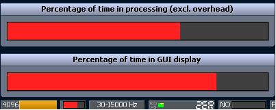

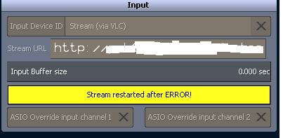

This morning i have message "stream restarted due to Error" and guess what
The "percentage of time processing was about more than double UP filled ? Why is that ?
File comment: The error and see the Cpu indicator
File comment: After restart and the CPU indicator

The error is most likely a loss of the incoming stream. CPU load: No idea...

The error is no problem . The interesting thing is that the CPU load in task manager was not "increased" . Only the ST CPU indicator. That is why i ask . Then the problem is may be some refresh after restart the stream . Something is not measured correctly after reconnect or something is added to the measurement. I don`t know.

I have that error again , but this time Cpu indicator was not going UP . Just mention this because this time everything is OK

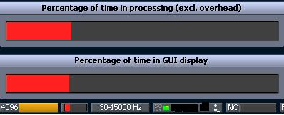

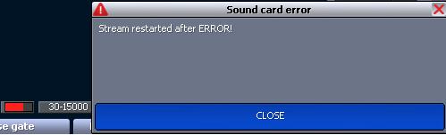

Hans ,
i think i found what`s happened .
It`s not double up the CPU but the indicator turns Negative . The red filling is the Free timing . When i move the mouse , down indicator is "emptying" like it should "filling" and when i stop moving it "fiils" to where it must be empty . Strange .
Look at the picture before - the empty space is nearly exactly to the filled (red) one above.
I think this is happened after certain times of reconnecting/restarting the stream.
If it is not like this, there is one more thing - In the time of "high" CPU load , the output buffer is unstable and "half" filled. If everything is OK , the output buffer is Full filled of blue.I`m talking about FM output buffer.
Also when this happened the Input soundcard in this time is "grayed out" :) and synchro is going to other parameters . Normally they are 2.000 to 1.000 , but when this error appears they are like normal playing 1.002 to 1.000
Hope that help if you can check it.

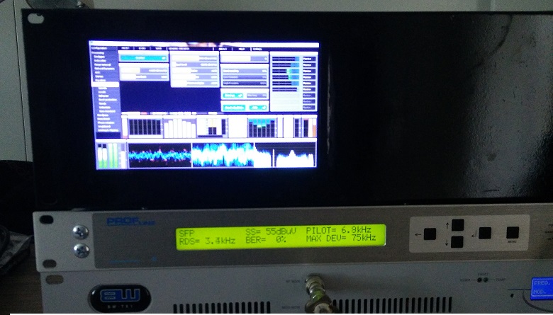

Indeed, that will be nice for my 7inch screen (bad quality picture, because of upload size restriction)

Excuse me PowerSound but what is that mean Pilot=6.8 KHz ?! RDS=3.4 Khz ? Modulation of the pilot and RDS ?
 Post subject: Re: Stereo Tool 7.50
PostPosted: Sat Aug 02, 2014 7:37 pm
Posts: 4248
They are also measured same like modulation. "kHz" :)
Pilot 6.8kHz is around 9%
And 3.4kHz is around 4.5%
