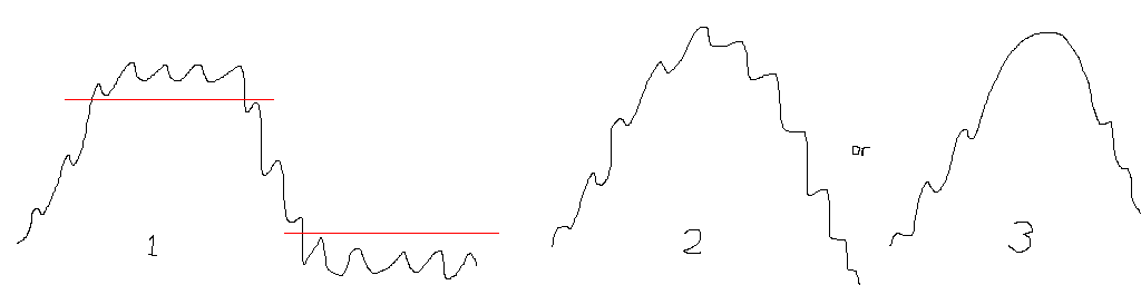

Because I'm a real artist, here's a drawing of my problem:
Say this is either an MP3, or a recording clipped with filtering (such as the Lady Gaga track).
See image 1. To be able to restore anything, I *need* to consider the samples above and below the red lines as clipped.
See image 2. Hopefully, restoration leads to this, which is very close to the original, except that the bass has been un-clipped.
See image 3. But it could potentially also look like this.
The closer I move my red lines to the top, the bigger the chance that I will fail to recover the bass. But the further I move them away from the top, the bigger the chance that I fail to recover the highs.
Ow, and to make things more difficult: The sharp angle in the "clipped" bass waveform also contains high frequencies. So I cannot separate them.
question: "clipped" contains highs but when it's recovered, it should contain less highs, or only harmonic form that high tone will be at output ?
 Post subject: Re: De-clipping filter
PostPosted: Sun Mar 27, 2011 1:21 am
huh...
Well, that's the problem. Recovering means complete removal of those highs. But in the case of image 3 also a sound that should not have been removed is gone. So both are treated the same way - but they should not be. And there's not really a way to separate the two.
If highs are also clipped, they should come out LOUDER instead of softer! But other highs (clipping artifacts) should be removed.... :shock:
Also remember that I draw an extremely simple example here: If a few more frequencies and a hiss sound are present it looks like a complete mess. And all of those sounds could be clipped and have harmonics (that's what makes the examples in the .WAV file I posted earlier so difficult).
