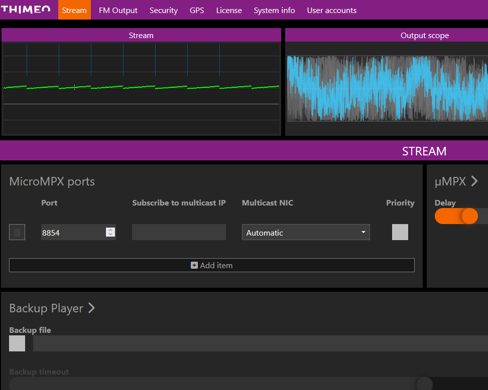

I'm in µMPX Decoder 4.2.010.11 BETA0
When start web interface I see correctly the port number
But if I go the another Tab and come back, Port number is not displayed correctly
Possible to correct this ?
Thanks
Stef
