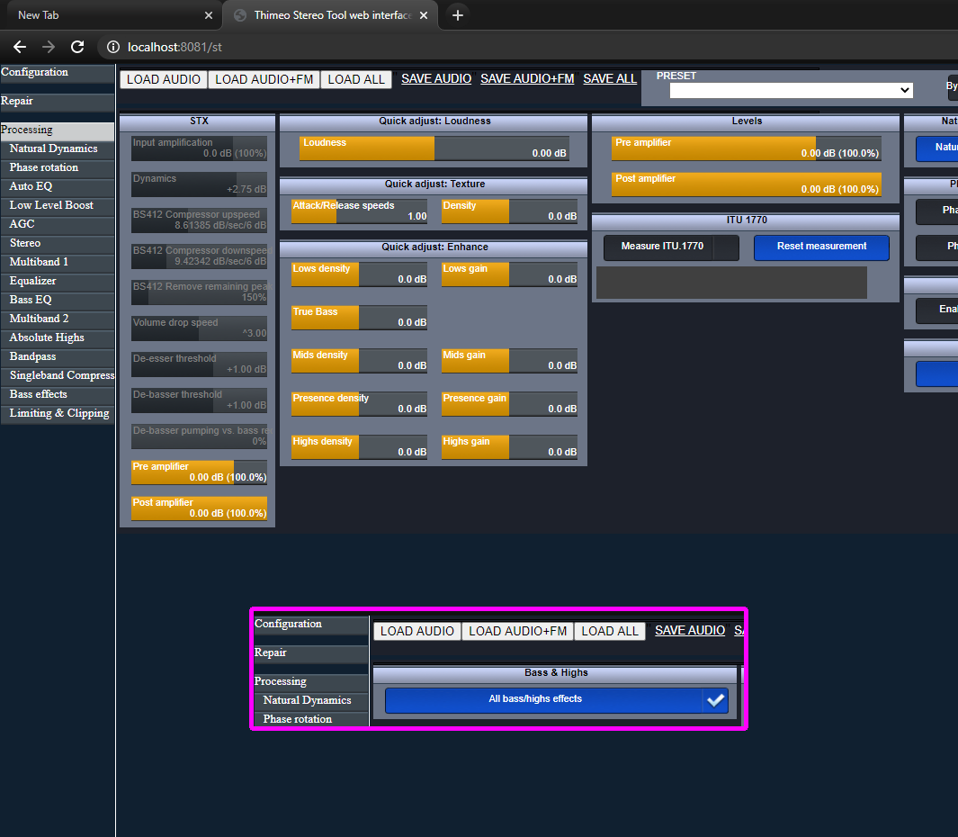

So, I was using the web interface on my phone from across the house. After switching to desktop mode, it somehow began showing some STX options, virtually all unusable. The one thing usable was a bypass for all bass and highs effects (and it didn't affect the bass clipper) and I thought that would be a handy thing for regular ST itself. I hope this is intentionally included in the web interface on the next update! I understand why it might not fit in the current UI, however. Or better yet a wet/dry for that bypass would be amazing.
I've been unable to reproduce this successfully. I'll keep trying. Note: my ISP currently doesn't connect to these forums, but it does connect to stereotool.com, and I'm currently using a browser based VPN to submit this. I don't know if this server communication weirdness has anything to do with it.
edit: When I came back to my PC, the extra options were definitely not in the plugin interface.
edit2: Okay, so it happens after restarting the plugin host, before opening the 32bit VST UI window. If I try to connect to the server within that period, it'll show STX settings to the left in the web interface. But once I spawn the UI window, those settings disappear. Will try to replicate in other hosts than BreakawayOne.
edit3: Tried again in Windows/Chrome instead of phone and it still appeared. Was able to get a screenshot.
edit4: STX stuff also appears via web interface using VST3 in Reaper as long as I don't spawn the window.
File comment: Some STX stuff showing up in Web interface before plugin UI is spawned

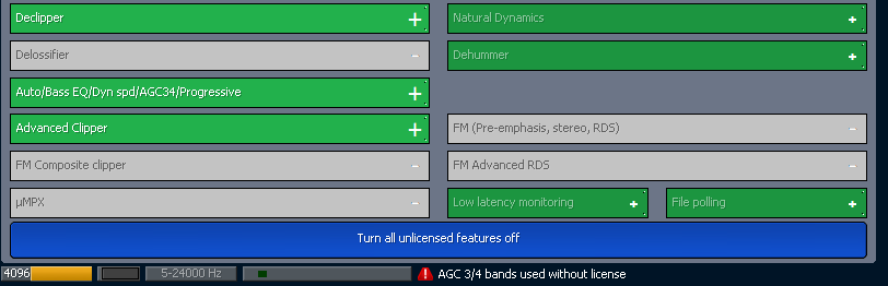

Hm, bands 3/4 require the advanced dynamics license, which I own. However, they're showing up as being used without the license, while the license is lit up with the big green + in the config. It appears to be this way on all the versions I've tried (vst2 32, stand alone 64, vst3 64)
I'm excited to dig in!
Same here:-)
PostPosted: Fri Sep 18, 2020 7:50 pm
Posts: 11424
Looking into it now!
Edit: Found and solved. I'll run a new build tonight.
