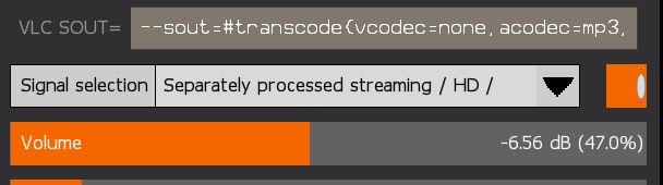

GUI - Enabling separate process streaming adds something to the end of the display (small orange bar?) but is too small to work out what it is there for.
Does not affect the operation, although one does not know what that does to know if it should or not! :D

Ah! I should probably clarify that one. It lights up if there are 2 processing chain active (so it's not a setting that you can change!).

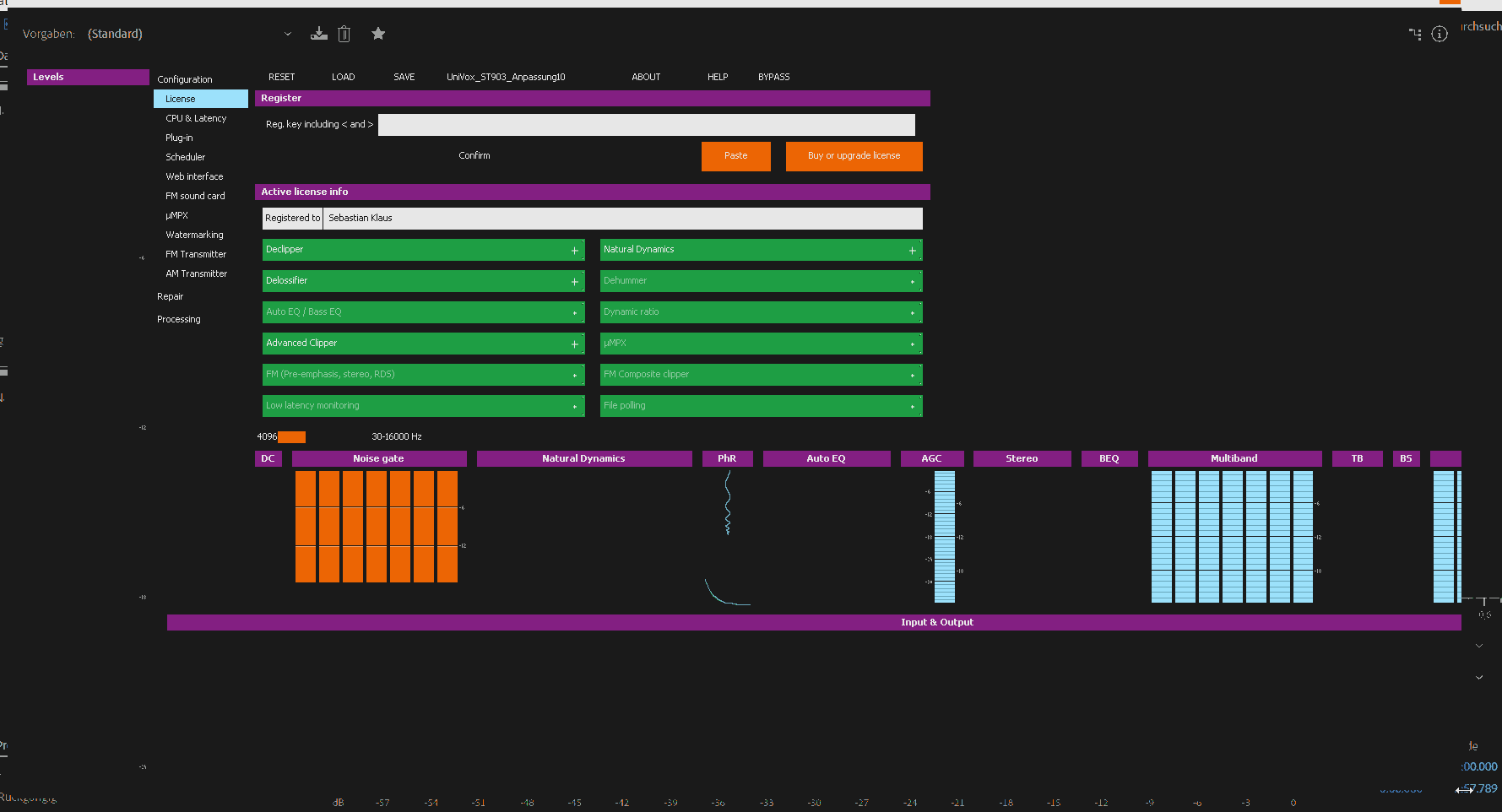

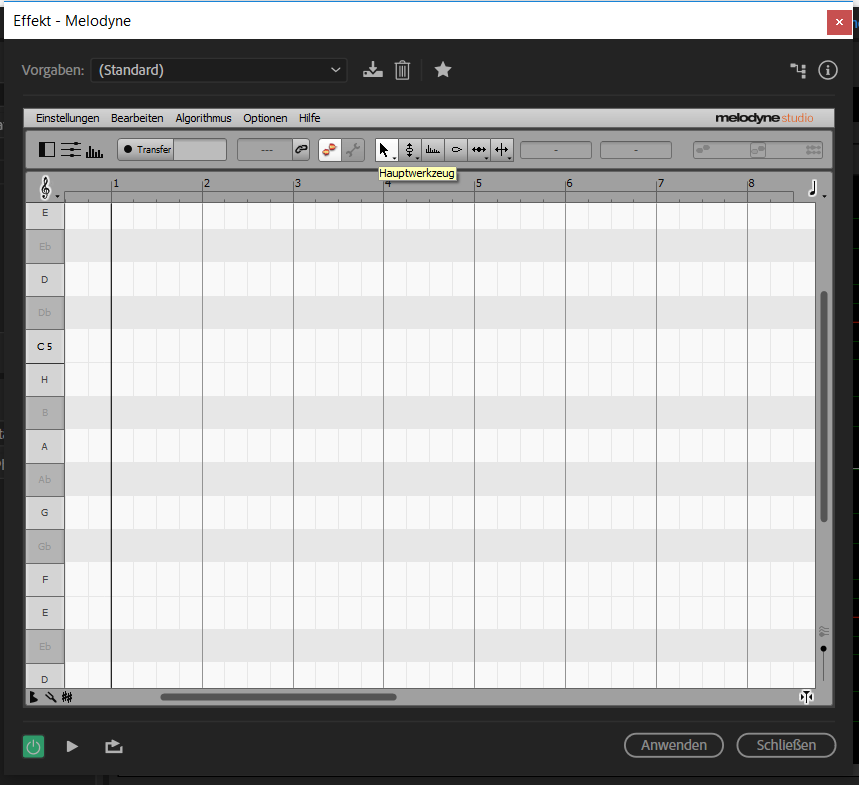

So the VST 64 plugin is now executable. But there are some problems with the display. Firstly, the display is so large that everything is not visible, and this completely overlays important control elements. If you scale the window, the area that is faded over flashes. It looks as if parts are rendered that should not be rendered at all.
I once attached a GIF that shows the problem well. If you resize the window, you will see in white the area where there are still controls. However, these are completely blended by the StereoTool.
But it seems to be purely due to StereoTool, because if I choose another VST3 plugin, then everything works normally, see second picture.

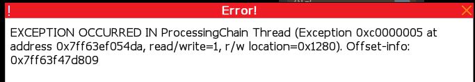

Hi Hans
Heres another on in Bypass (came up after 15 mins or so).
EXCEPTION OCCURRED IN ProcessingChain Thread (Exception 0xc0000005 at address 0x7ff63c7a493e, read/write=0, r/w location=0x0). Offset-info: 0x7ff63f47d809

Do you have a C:\temp directory? If so, there should be a file there called StereoTool_Exceptions_Log.txt . Could you send that to us? I expect that there's another error that causes this one.
Hi Hans
EXCEPTION OCCURRED IN release_ss: index >= 0 && ss[index] == s
EXCEPTION OCCURRED IN release_ss: ss_inuse[index]
EXCEPTION OCCURRED IN ProcessingChain Thread (Exception 0xc0000005 at address 0x7ff63ef054da, read/write=1, r/w location=0x1280). Offset-info: 0x7ff63f47d809
Hope that helps!
Ross
Wow, it's something in the analog compressor code (which really makes no sense in bypass mode - but it's clear that that's where this is coming from). I haven't touched that code in quite a while though. Can you send me your FULL settings (via a PM) so I can try it here?
