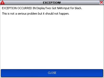

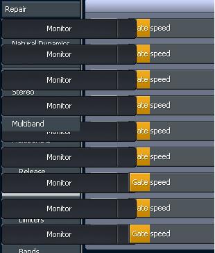

Monitor buttons in the new gate panel are above left menu (some GUI mess). Please don`t tell me it will freeze again :)
Also when i was sliding the "release gate freeze" option got this window (see second picture).I think it`s caused by this GUI mess with the Monitor options.
