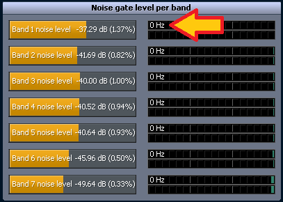

I have a question... This is a GUI error in the Noise Gate section (0 Hz in all lines/bands)?
