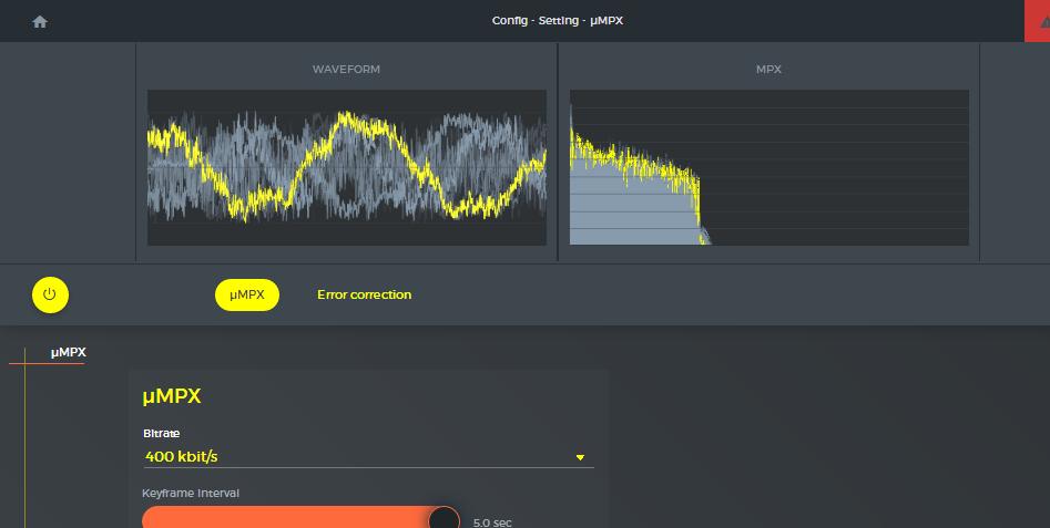

I don`t see MPX signal on the right , am i missing something ?
This is the Encoder, input is a Virtual cable on 192Khz, source is from Winamp . This is what i have in Encoder...
ANy butoon for enabling MPX processing? I don`t see any
I don`t see any field for IP , in the Decoder. How it will connect to the Encoder without this ?
PostPosted: Fri Jul 20, 2018 5:39 pm
Posts: 11520
@DJ_DOGGY: MicroMPX is a codec to transfer an MPX signal, not left/right audio. Hence the 192 kHz input, and the fact that you don't see any MPX (the input must be MPX already).

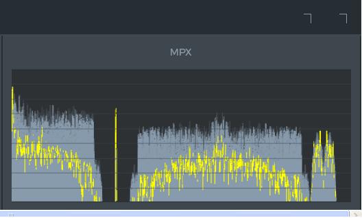

And here is my picture with side effects. 15000Hz lowpass, allmost "touching" the RDS, just a little more aaand...
But looks OK
But looks OK
Not strange... the purpose is not to have a server that listeners connect to, but one stream that goes to all the transmitters. Which could be using multicast (1 stream that reaches all the transmitters at once, without needing extra bandwidth). Or for example via satellite, where you only have 1-way communication.
Other solutions for this work the same way.
