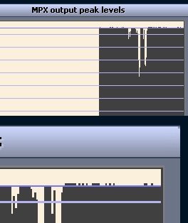

HARD LIMIT does not work properly, output "peak"! moments after 87 kHz!
Still didn't fixed..
Marcin
