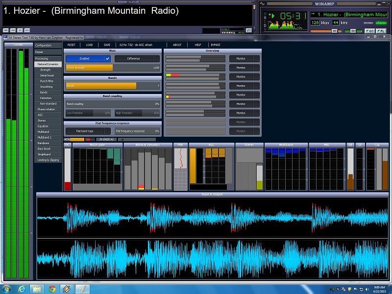

PostPosted: Wed Apr 22, 2015 3:19 pm
Posts: 45
- Changed some GUI things (for big displays)
GORGEOUS!
Thank you so very much!
