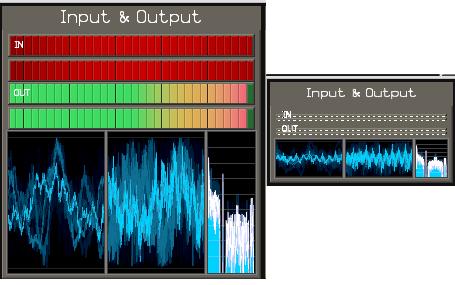

No, About the IN/OUT indicators , they are not working in the GUI, not the icon at the taskbar .I Attach picture to see.
For the affection . I mean when we have FM output enable and program code stereo and RDS , when i enable the normal output which is not enabled to this moment FM output is stopping for a moment and then again starting . When disable the normal output then stopping is for a long moment than when i enable it.
A kind of gap when enable/disable outputs.
Ah, the actual problem here is that you shouldn't be able to make the window THIS small...
Technically, the I/O stuff does still work at the smaller size. You see flickering going on.
As for the window size itself, it is the exact same minimum size as 6.32, and just installing over top of 6.32 with the window size set for that leaves the size alone.
