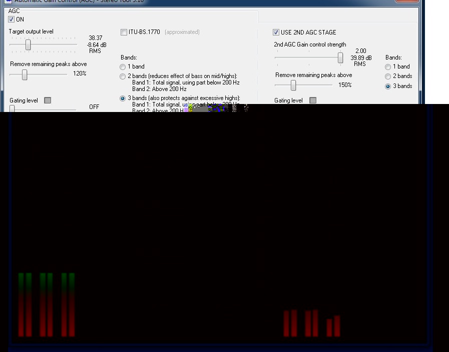

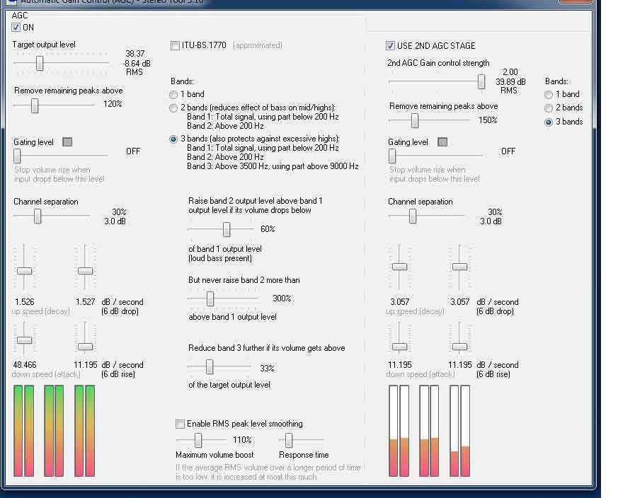

Perhaps I am wrong, but I think there is a bug in the VST version since beta7. When I activate the 2nd AGC then the first stop to work.

oops, there is something wrong with the picture, here again

Hallo,
Not necessarily. The two AGC's combined will try to reach the target level. The 2nd is set to VERY strongly affect the audio level, which means that the 1st will do less.
Try lowering "2nd AGC Gain control strength" - default value is 1.00 (2.4 dB instead of 39.89 dB as you have now!)

Posts: 22
Thank you Hans for your fast answer.
With your suggested setting of the second AGC to 1.00 it works well.
