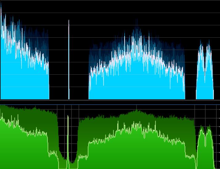

PostPosted: Fri Jul 20, 2018 12:51 pm
Posts: 118
Stereo Tool 9.02 BETA015
Windows 64 Bit Standalone B015 + microMPX B016
Would be possible (or worthwhile) to add a command line to microMPX to allow for a pilot and/or RDS guard (filter) to protect either of them from transients/audio spikes?
The top is ST output into a low power test TX, the bottom is me decoding the same signal via MPXTool.
At the level where I can no longer decode RDS via RDSSpy from the PIRA using the microMPX output (same card type), can switch across to the MPX output into the same TX and reduce power by another 15-20% before I loose RDS from the MPX derived from ST directly.
I realise that some of this stems from the the nature of the codec (per previous post) but thought I'd throw the idea up for review.
Cosmetic display bug: The FM Lowpass frequency value is being shown on the main screen for both the FM and Bandpass Lowpass frequency values.
