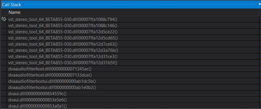

So, I've re-enacted the problem and opened the minidump in Visual Studio. The following call stack is displayed there. I hope this will help you in troubleshooting. If you want the complete minidump, please let me know!
Just as a supplement. The error occurred with beta 28. The error did not occur before. It can therefore only be due to an adaptation in this version.
Unfortunately these addresses are different in different OS's/different runs. So, I can't use those. Also, this version was built without any debugging information whatsoever (even on my end - so even with the correct address it would be difficult to figure out what's happening). I've turned on the generation of files on my pc now (it was off because it makes the build take even longer, and it's very rare that people respond issues in the 64 bit VST version).
There's quite a lot changed between these beta's, but nothing VST related, so I think the first thing I should do is to run the latest version in Valgrind. Also, I have a lot of optimization work to do, so it probably makes sense to do that first - I will probably throw away parts of the new code. I might just get lucky and throw away whatever is causing this crash :)
